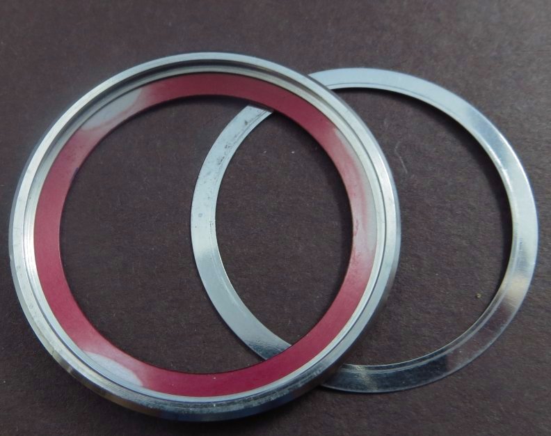

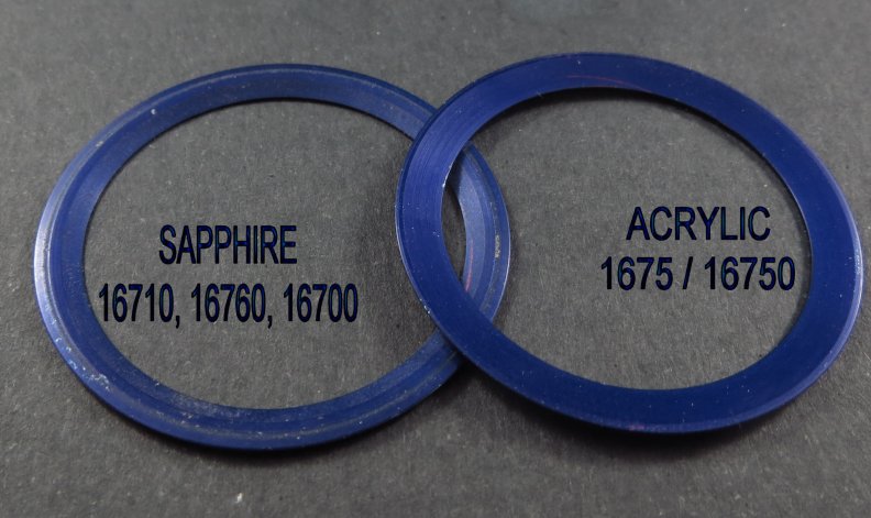

If you know the subtle differences between the acrylic and sapphire inserts when viewed from the back, it becomes very apparent whether a GMT insert fits an acrylic or sapphire model.
The sapphire inserts will fit on the 1675/16750 acrylic crystal models – especially if the insert is flattened out a little with the help of a wooden dowel or other item. The bezel will spin freely when installed - even though the inner diameter is slightly less with the sapphire insert than an acrylic insert.
I have placed several photos here depicting the differences between the acrylic inserts (1675/16750) and the sapphire crystal inserts (16760/16710/16700). When viewed from the back, the acrylic inserts have a very thin ring on the outer edge. The sapphire inserts have a thicker outer ring when compared to the acrylic inserts along with a middle ring. When viewed, the sapphire insert appears to have three distinct rings on the back while the acrylic insert appears to have two distinct rings.
In the photos below, I have included a GMT 16750 that has a sapphire insert fit to the bezel and installed on the watch. It fits tight and the bezel turns freely.

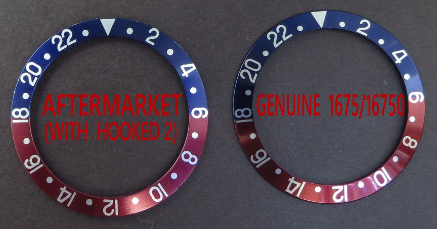

The most common variety of aftermarket GMT bezel inserts have a distinct identifier in one of the numerals. In examining the 2s, if you look closely at the upper top loop of the 2, you will observe that this loop hooks excessively past the base of the 2 which gives the numeral a very distinctive hook which is not like the 2s found on genuine inserts. This type of insert is referred to as the "hooked 2." There are several photos of the "hooked 2" below comparing this aftermarket insert to genuine inserts. One must also be aware that the back side of these aftermarket inserts appear very similar to genuine inserts.
The "hooked 2" inserts can be found for all varieties and colors of the GMT models. From the two-tone brown inserts, gold, black, blue, red/blue, red/black etc., there is a "hooked 2" insert being made.

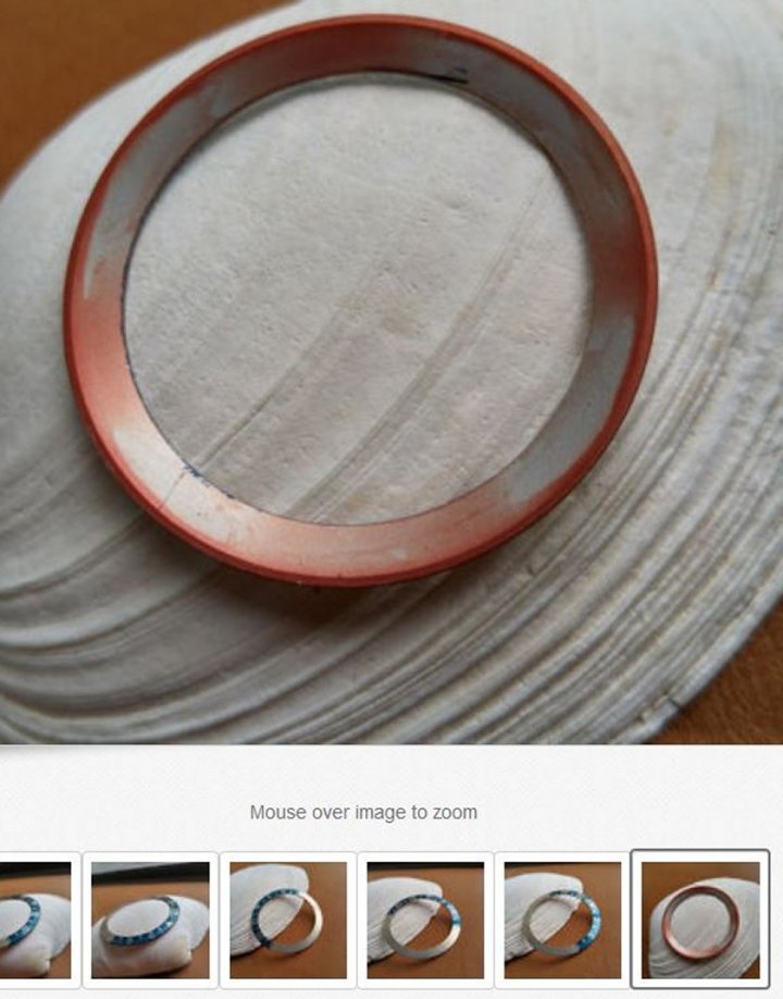

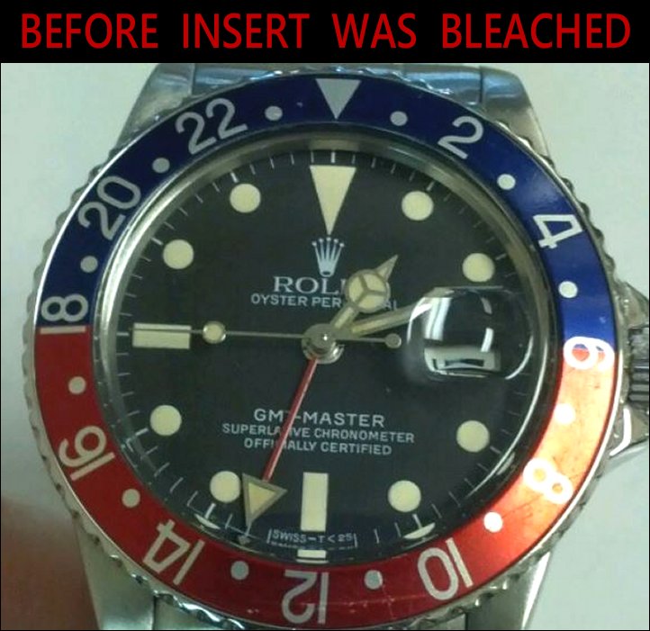

BLEACHED BEZEL INSERTS

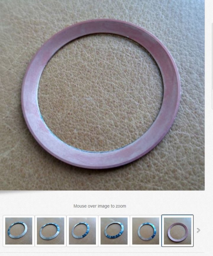

Artificially or chemically "bleached" inserts are a rather new phenomenon which seems to have gained prominence the past three to four years. They can usually be identified by splotchy colors or uneven fading on the insert. Additionally, from my experience, the back side of the insert is usually overly-faded too, or has splotchy coloring which is indicative of a chemically altered insert.
I have also seen inserts that were chemically altered while the insert remained in the bezel. This type of bleaching is fairly easy to identify when the back side of the insert is examined. Normally, when you examine the back side of a suspected "bleached" insert, and you observe a distinct, darker color around the outer perimeter of the insert, it was probably "bleached" while the insert remained in the bezel. Normally, from the hundreds of inserts that I have seen the past couple of decades, most inserts on the back side retain the vibrancy of their original color, regardless of whether the top side of the insert has a naturally, aged color.

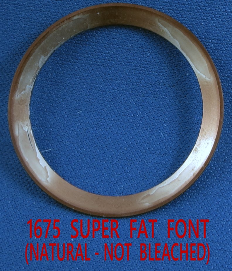

Additionally, I have seen inserts from the 1960s that have a nice, faded patina on top but when you examine the back side, it appears to have an uneven or splotchy colors which might lead one to believe that it was artificially faded. This appearance is quite normal on some of these decades-old inserts and no need for alarm. (I have included a couple photos in this post depicting a super fat font GMT insert with these attributes. (I have made another post in this thread depicting the back side of some genuine, red back inserts that have fading or splotchy marks that appear to have been artificially aged but they are not. )

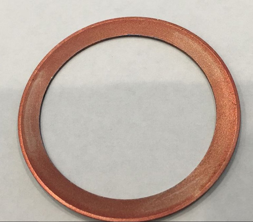

Re: GMT Bezel Inserts, Aftermarket Inserts and Bleached Inse

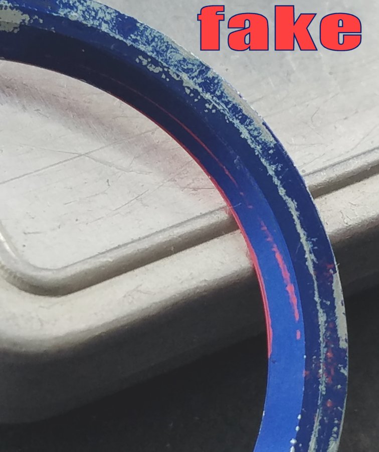

Here is another fake insert that I recently came across. It is made from thinner aluminum than genuine inserts and is much more pliable
than the genuine inserts - it bends very easy.
The back of this insert has the appearance of a sapphire insert with the three angular bevels like those found on genuine Rolex
sapphire inserts. It also appears that attempts were made to artificially bleach the insert as depicted in the photos here.
The "hooked 2s" seen on many of the fake inserts are missing from this fake example.
It is easily identified by the "4s" where it is pointed where the vertical and horizontal lines meet to form the 4 on the left. On genuine Rolex inserts, there is a flat spot just before the intersection of where these two lines meet. Below you will find photos comparing the 4s from this fake insert and with a genuine Rolex insert.
