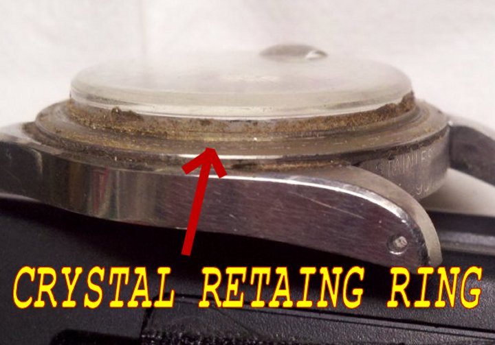

The crystal retaining ring, which is what the bezel snaps on to, can cause many bezel issues if it becomes worn. When this happens, the bezel itself does not fit as tight as it should and the bezel may pop off when it is struck against a wall or door jam. While the crystal retaining ring can be replaced if it becomes worn, there is an old watchmaker's trick that may be used to tighten these crystal retaining rings so the bezel assembly fits tight to them once it is pressed back on to the retaining ring. (I'll discuss the method for tightening the bezel crystal retaining ring later in this post.)

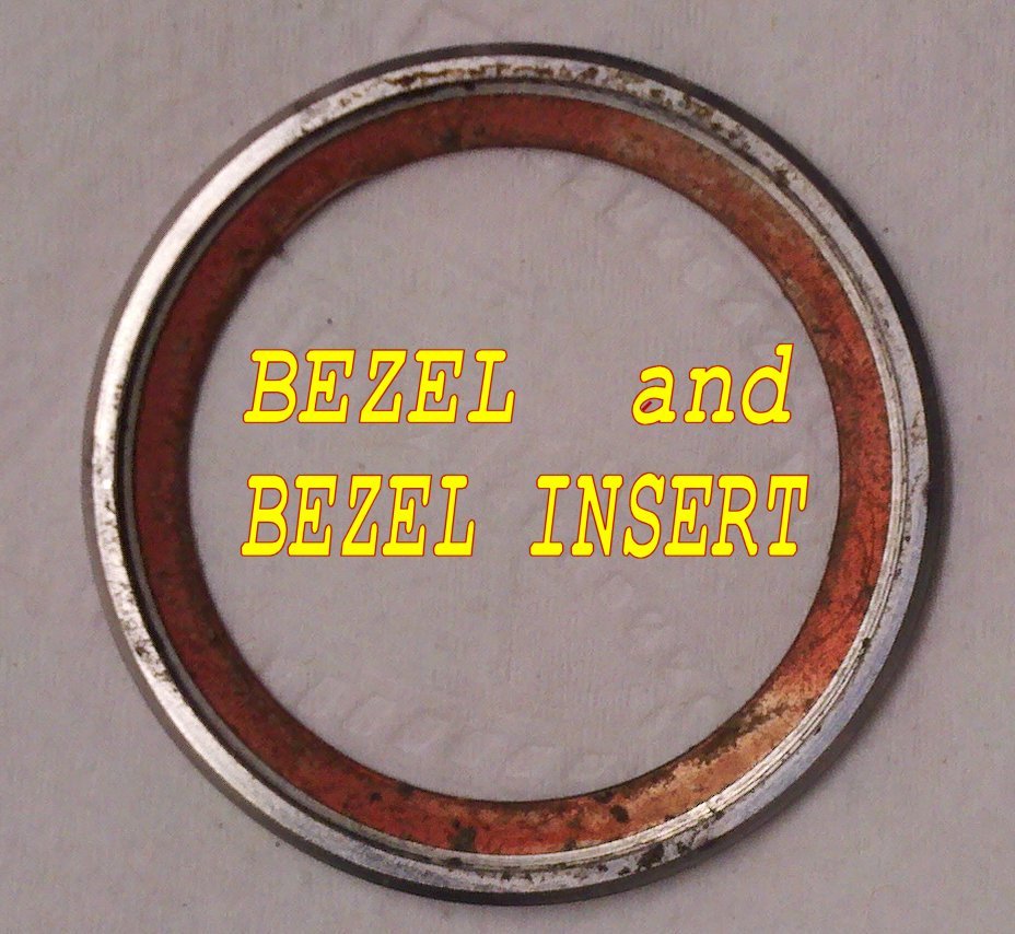

Additionally, the bezel itself can become worn from years of wear. Proper diagnosis for ill-fitting bezels should be properly diagnosed to determine if it is the bezel, crystal retaining ring or even the flat spring causing loose fitting or bezel binding issues.

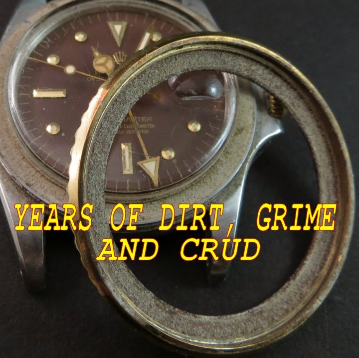

If these four parts are not in sync and fit properly, bezels can become too loose causing the bezel to fall off or the bezel might become too tight causing excessive friction on the bezel assembly to the extent that it will not turn properly. A couple of these parts can affect whether the bezel is too loose or too tight. When a bezel becomes too tight, it does not turn properly or does not turn at all. Sometimes the fix for a bezel assembly that turns too hard or not at all might be as simple as the removal of the bezel and bezel flat spring assembly and giving them both a good cleaning removing years of dirt, grime, soap scum and DNA.

B) Once the crystal is installed, the crystal retaining ring is press fit over the crystal causing a tight seal to prevent water from entering through the crystal.

D) Next, the bezel insert is snapped or pressed into the bezel. This can normally be done by pressing the insert into the bezel with your thumbs, or, with plastic/nylon tipped pliers, a round pencil or other make-shift tool.
E) Finally, the bezel assembly (the bezel and insert) is press fit onto the crystal retaining ring with your fingers or possibly a special bezel press which is made for this purpose. Personally, I have never found the need to invest in a bezel press, push fitting the bezel/insert assembly on to the watch with my fingers has always worked for me.

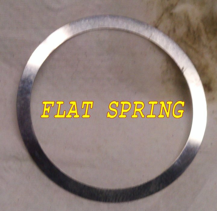

One other area that can create problems with the bezel assembly is the flat spring. If a bezel assembly turns very hard, the excess friction could be from the flat spring. One way too check this is to remove the bezel/insert assembly and flat spring - then reinstall the bezel assembly without the flat spring. If the bezel turns much better, the flat spring is causing too much tension and binding. The flat spring needs to have a small amount of metal removed from the outer diameter by turning it on a lathe. This should be done in very small increments. If too much metal is removed from the flat spring, the bezel assembly will turn too freely and the flat spring will need to be replaced.
Below are a few photos depicting the parts that I have discussed in this post. Pay particular attention to the photos depicting the crud, dirt and DNA that has accumulated on the bezel retaining ring, bezel and bezel insert from years of neglect and lack of cleaning. When you see something like this, it is not hard to understand why a bezel assembly might have issues turning properly. A good cleaning is the first place to start if you are having bezel issues.
